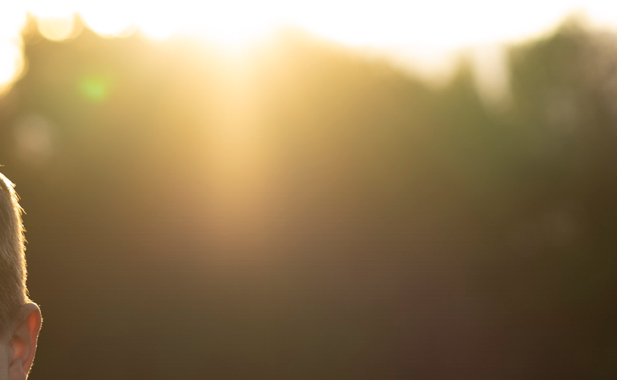

Hello community.
I am really hoping for some good answers on this one :slight_smile:
Her is an image example if needed.
Imagine these stripes over a face. It is pretty tough to get rid of.
Piscie
Hey @Kristian-R, does it happen while shooting in sun only? Did you try to initialize the camera settings as mentioned here?
profile.country.NO.title
Kristian-R
Hello.
I have only discovered this in straight sun.
I have not reset my camera settings, but it`s worth a try.
The explanation though, is something about the autofocus system.
Piscie
Hey @Kristian-R, keep us updated with the reset outcome! You can also try to adjust the autofocus function by following this
