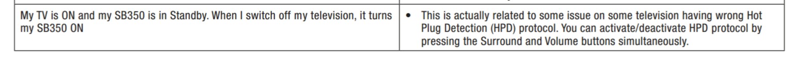

However i did find this :
Your TV definately complies with the ARC standard and the HPD protocol, which basically is Pin 19 on the HDMI cable/port. I am wondering if this is deactivated on your speakers? Try pressing the buttons on the front of the soundbar as suggested above.
However, if that doesnt work, I would honestly change the HDMI cable, in case it is faulty. Ensure you get adecent one, complying with at least the 1.4 standard. I use these ones HERE, they are great at a reasonable cost too.
