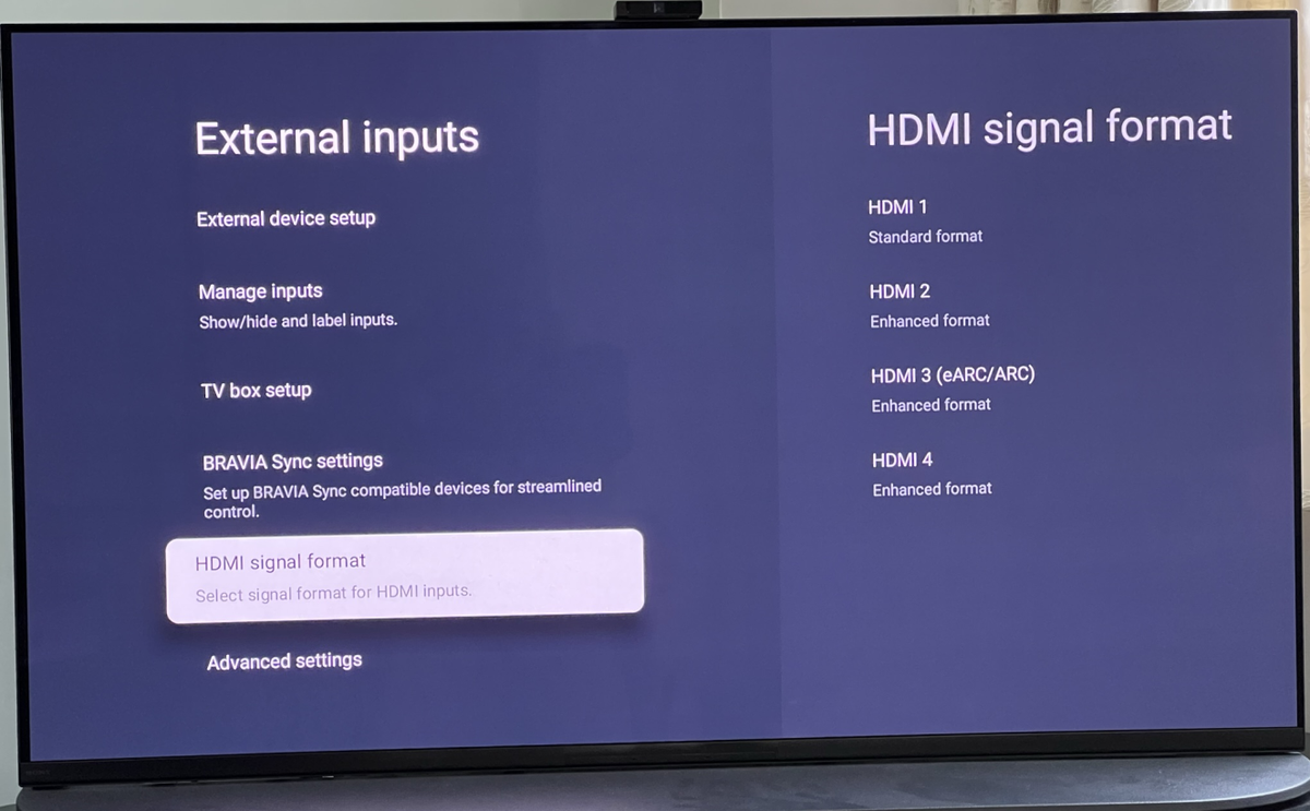

I have an Apple 4K TV set to 4K Dolby Vision connected to HDMI 2 and zero problems with Dolby Vision on my XR-55A95K. Simply ensure that the HDMI input you choose is set to Enhanced Format (see below, I have HDMI 2 set to Enhanced).
Alternatively pass through your PS5 using the HDMI IN on the HT-A9 (I assume you mean A9 and not 9A). Page 8 of the HT-A9 manual states it supports Dolby Vision video.
HT-A9 Manual - 50252301M.pdf (sony.com)
