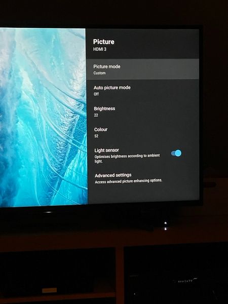

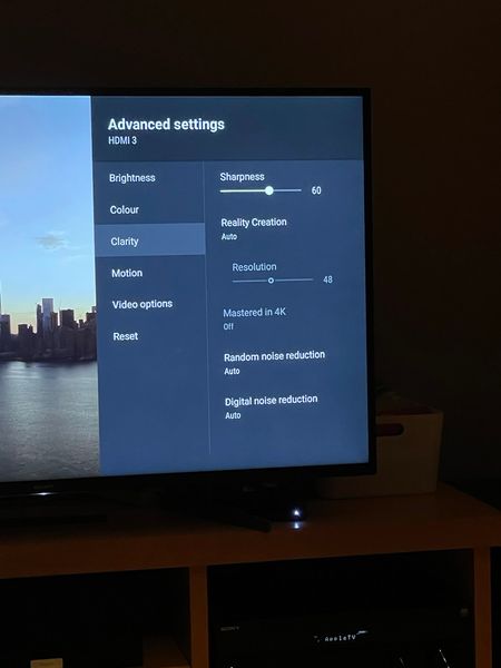

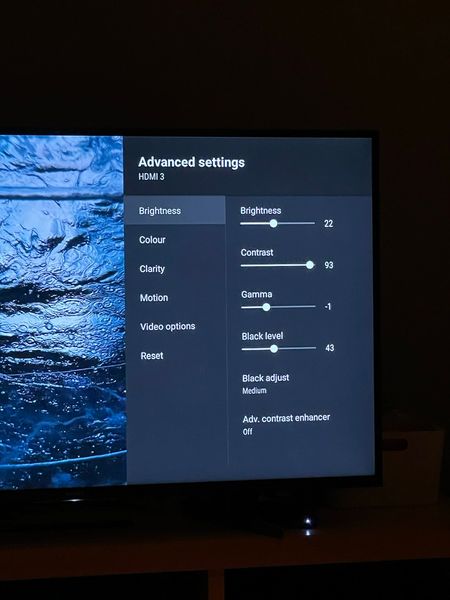

BJL1980
Here are the photos of my settings. Power saving is set to OFF. There is also a link to a video showing an example of the problem
https://youtu.be/eWPLQH_6gCQ

mmm, i am not sure I understood from the video which is the defect you are trying to highlight..
In any case you have a tons of algorithms activated (light sensor, black adjust, live color, reality creation, noise reduction) and other setting that are not clear why you changed (sharpness, black level, color)
By resetting the tv, I mean also leave the preset and see how it works before changing anything to your desire...
