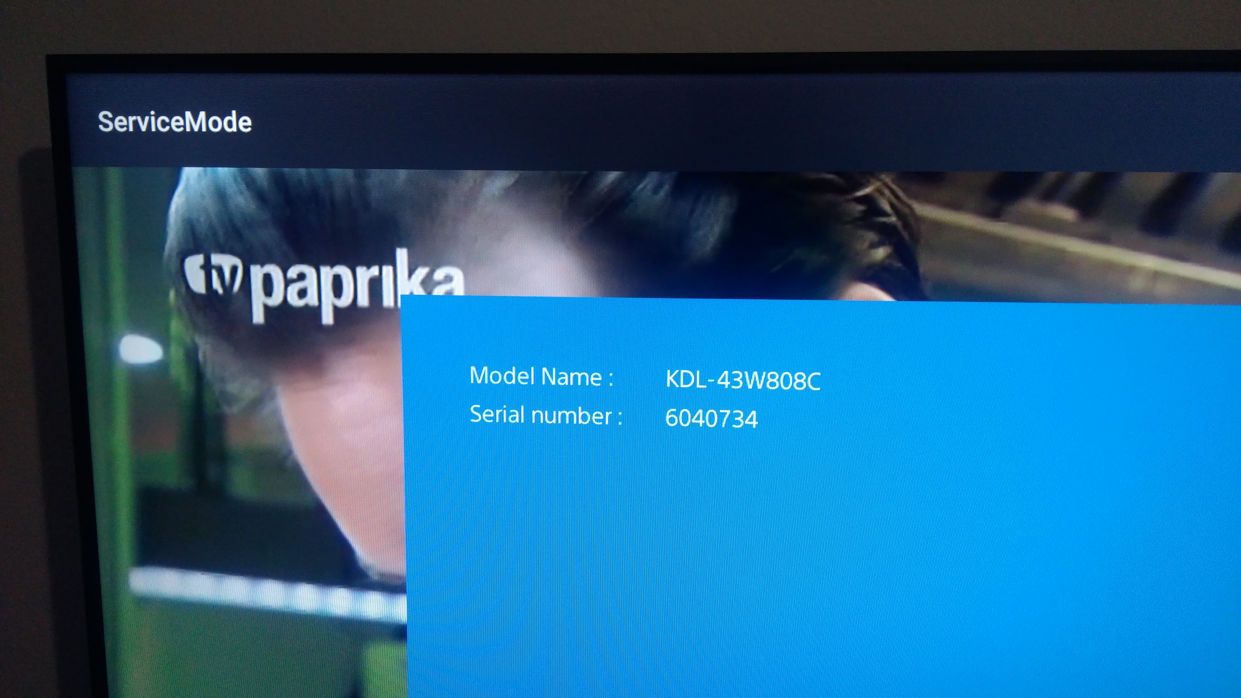

Hi all. I've found the way to get into the service menu. You have to press the folowing buttons one at the time in the the following sequence on the remote controll: i+, 5, volume+, power. Be very careful what you are doing in this menu. In this menu you can check your model number.IMG_20170312_172530.jpgIMG_20170312_172439.jpg
