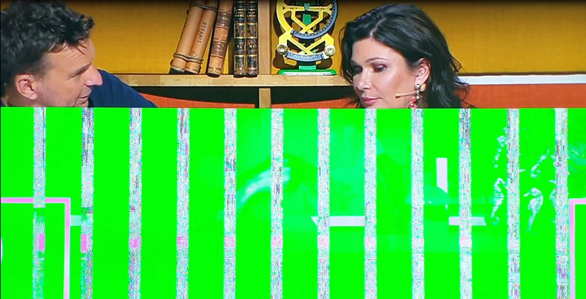

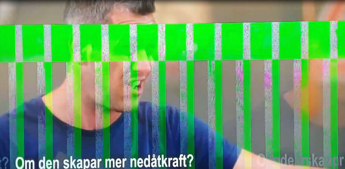

I have some issues when i have APPLE TV connected to SONY X900H TV showing green bars
I have tried same APPLE TV HDMI cable on a other SONY TV and 2 other LG OLED TV, no sign of green bars during these tests
Is green bars X900H issue or is it a APPLE TV issue?
How come i got no green bars testing same APPLE TV on other TV?

I tried post picture with my first post, but got a red message it was not allowed, so i don't know what format showing pictures is allowed here?
HannahEd01
Try JPEG?
profile.country.SE.title
MickeJGS
HannahEd01
I see, that might be the HDMI port, did you try unplugging everything from the TV and unplugging the TV from the mains for two minutes? Also, what's the current software version on your TV?
MickeJGS
I can only use port 3 for dolby vision
It have the current version from last week
Don't know if 2 minute will do different when unplugging
HannahEd01
Hey MickeJGS, try and let me know, also I believe that you can use 3 and 4. Did you try changing the HDMI cable as well?
