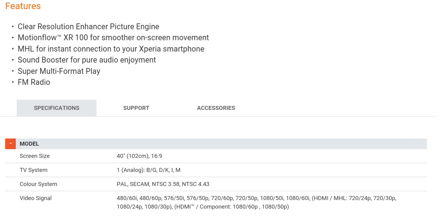

Hi there, i brought this exact TV in Dubai when i lived there in 2013. I relocated last April and brought the TV to the UK. It doesnt seem to work when i try to tune UK channels. Doe this TV work in the UK or only Middle East and Asia.
Thanks
Hi there
I had a look at the specifications of this tv, unfortunately it appears it has an analogue only tuner. I also had a look at the specs in the manual, they confirm the same (see pics below). So, in order to use this TV in the UK, you will need to purchase a Digital Freeview box.
From:
http://www.sony-asia.com/local/product/klv-40r452a
From manual:
