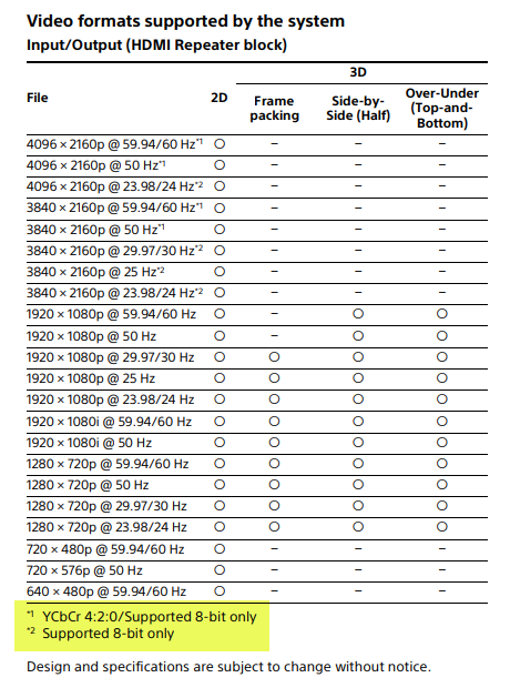

Htxt1 is old enough not have 4k passthorugh. It cannot work the way you hoped for

Mmm 2014 surely does not support HDR probably also HDCP 2.2

The problem I think:
Manolo
