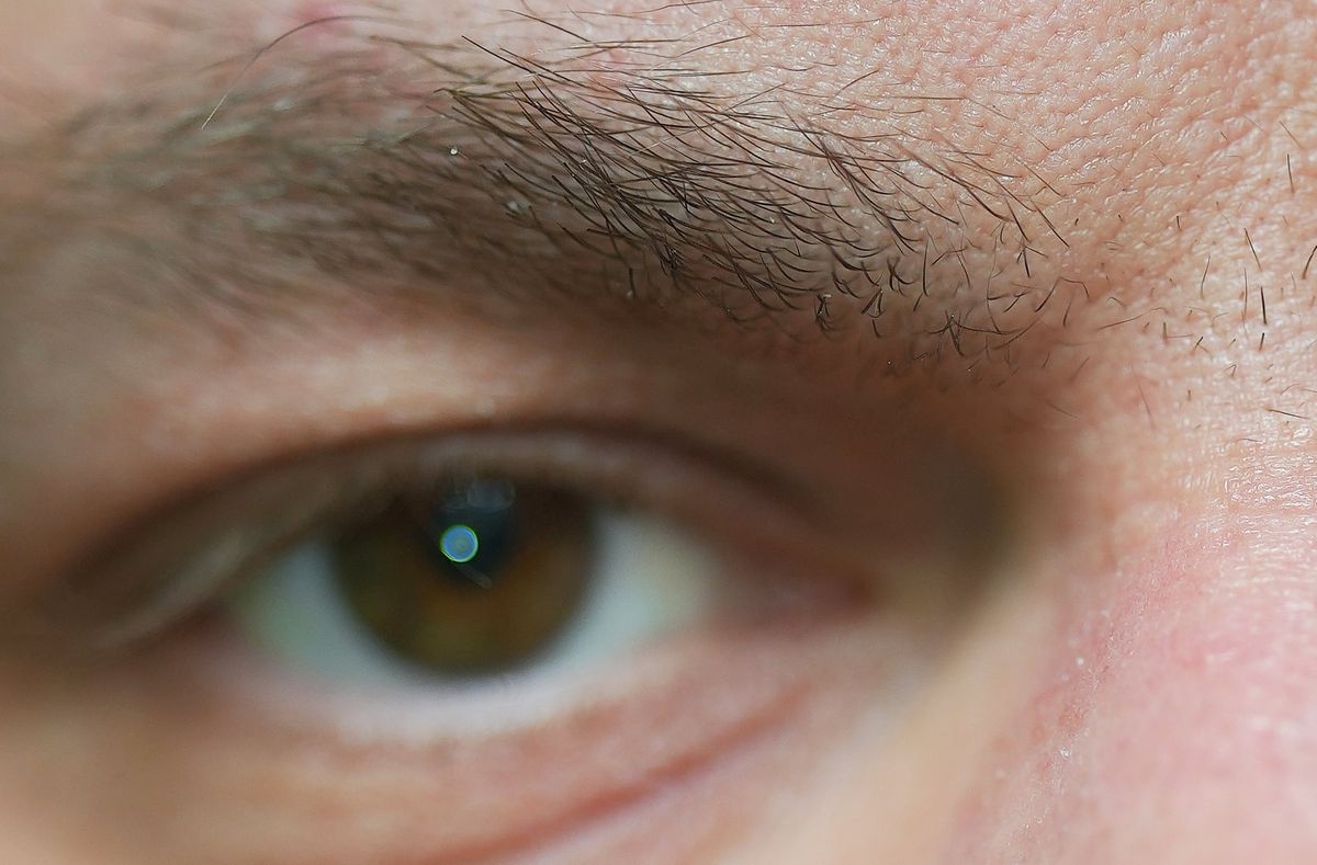

This is how the problem will look like by 75-90% with face portraits, if you are affected (135mm 1.8 GM @1.8 from 100cm distance in that case):
af01dfb3-77e2-4f43-9ce1-c963728cb51c.jpgaf01dfb3-77e2-4f43-9ce1-c963728cb51c.jpgfocus on eye brow.jpgfocus on eye brow.jpg
I hope this is helpful to other affected users.
Please open a support case, else it's very likely Sony will do nothing! Many users already reported, that Sony was telling them, they have heard that for the first time.
