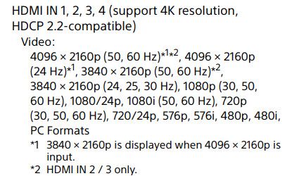

IamNic
Hello @alexhill,
the TV has a refresh-rate of 120Hz (NTSC) or 100Hz (PAL), it just doesn't support 120Hz/100Hz signals.
It interpolates the frames in between when using e.g. a 60Hz or 50Hz signal.
Could you please link the reviews, which stated it would work with 120Hz/100Hz signals, since Sonys product page clearly states the highes refresh rate signal it supports is 60Hz.
