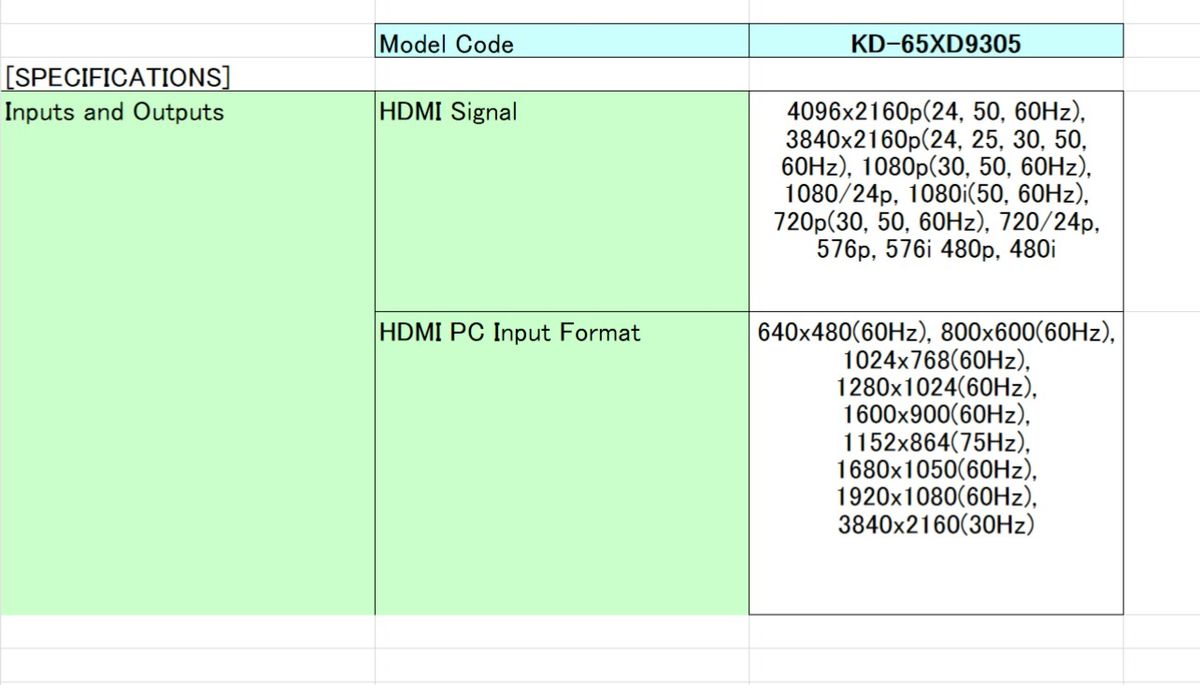

Unfortunately it doesn't make any difference, I can still only output at the same formats as before. I've been experimenting with a number of different colour formats, colour bit depths and refresh rates. The conclusion that I have come to is that my TV will only recognise the formats show in black on this Sony page. Clearly this is wrong, since my firmware is bang up to date so I should be able to use the formats shown in red as well.
Perhaps the updated firmware is not working properly with this model? I'd really like to hear from someone who has some of the signal formats in the red text in the link above working on an XD93...

Hi, my TV is the XD93 which is a 2016 model with a 10 bit panel. Its rated as being able to accept 4k 60Hz 4:2:2 at 12 bit over HDMI, as long as the firmware has been updated.
Basically, if you look at this webpage, my TV should support all of the formats in red but in reality will only accept the formats in black based on my current experimentation. Even forgetting about 10 bit or 12 bit, it won't even accept full RGB 4:4:4 at 4k 60Hz 8 bit as you mentioned you do with your model. That is only possible right now up to 30Hz.

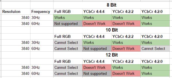

gobblerjook
Member
I completed a series of tests to explicitly show which signals work/don't work for Sony support, thought I would share here too:
