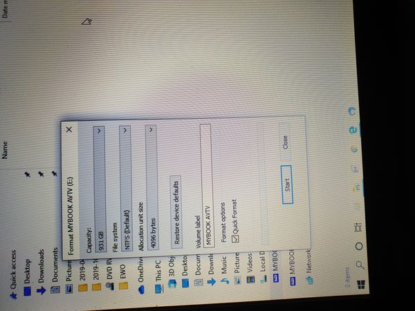

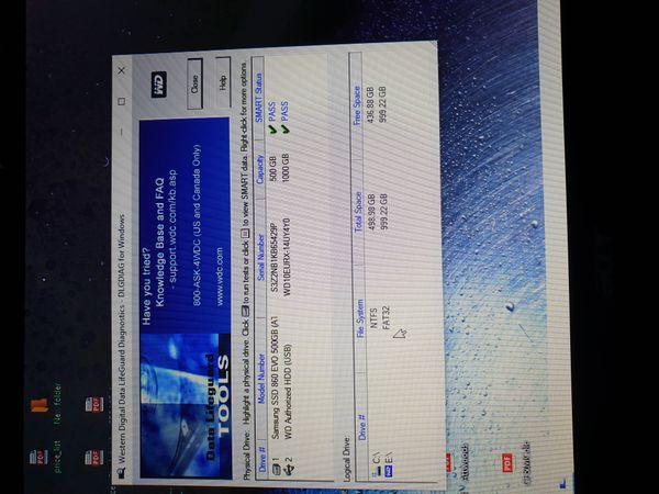

Hi rooobb - I downloaded Western Digital Data Lifeguard Diagnostics Software after visiting there website today before looking at re reformatting the HDD and checked the drive (see picture attached) it passed their test but I noticed it has a file system as Fat32 should it be the NTFS as you suggested. As I've never formatted a HDD before I see that the format process defaults to NTFS, also it shows Allocation Unit Size as 4096 bytes I'm not sure what this means as the HDD is a 1TB HDD, should the Restore Device Default be clicked (see picture attached) or leave it to someone how knows more about formatting HDD.

Hi rooobb - I've formatted the HDD from Fat32 to NTFS file system, I connected it to the TV and it got recognized.

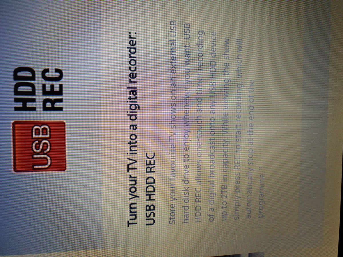

So all seems OK. Are you a expert for Sony as I would like to point out that when searching for a new TV I check out all the feature on the TV's and was brawn to the KD55-AG8 where it says you can record to a digital HDD but does not say that you have to disable Youview to be able to record.

Being classified as an expert on the forum doesn't mean I have any connection with the Sony company, I am just a customer like you.
Unfortunately you saw the advertizing but didn't have a look at the note "11" that is at the end of the features, thet says exactly that
You should have asked the question or looked at existing thread before buying the tv. Nonetheless no other tv as Youview and recording AFAIK so it doesn't change the scenario too much. And you bought a great OLED tv. Having a A1 myself of which I am proud
