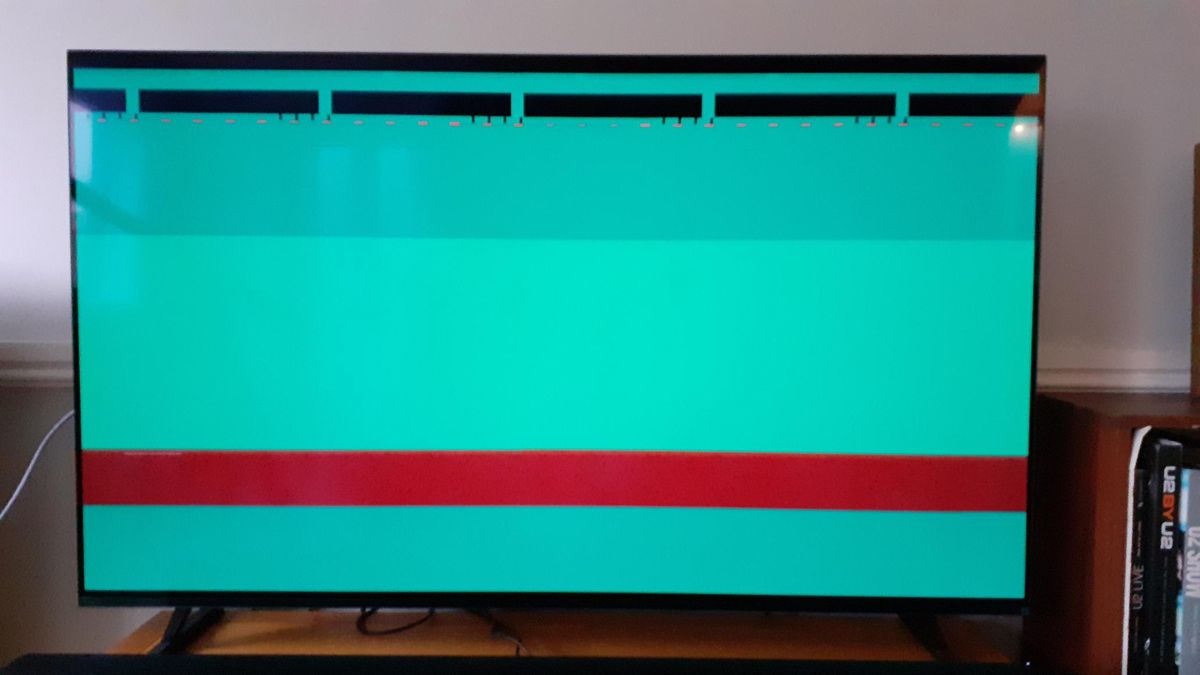

20230214_083348.jpg20230214_083411.jpgHi
I have a new Sony OLED 55" TV XR-55A80J that I have been trying to use as a monitor for my PC as well as a TV but keep having problems with the connection.
I am connecting a Dell XPS PC that I purchased last year using a HDMI cable to connect to the HDMI 1 port on my TV and then going into settings using the TV remote  to set up the device in the external device setup and choosing PC from the drop down menu which says it will configure the settings to display my PC correctly. Having carried out these steps, I then get a screen of interference (please see attached images).
This can be a intermittent problem as sometimes, if I go through the set up process again, it will decide to work but by changing the HDMI channels or doing nothing, the issue returns.
At first, I thought it was a PC issue until I purchased a second hand Dell monitor and connected the HDMI cable to that instead and it worked fine every time, so it's definitely related to the Sony TV and not the PC.
I cannot understand what is causing the issue here as I have looked online and YouTube for answers. I cannot use a VGA cable to connect to the PC or TV as there isn't a port for this on either device only a HDMI port. So I don't know what the solution is.

Hi @jolb72
What are your display resolution settings on your PC including the refresh rate? It has to match one of the HDMI signal formats supported by the TV.

When I checked the display settings on the PC when on the rare occasion the connection was working, I did notice that the display resolution was set to 3840 × 2160p (Recommend) and at 30 Hz (Recommend) refresh rate, which I didn't change as it said recommended setting. So are you saying this needs to be 100-120 Hz?
LightFoot
Specialist
Hi @jolb72
The 100-120 Hz is mainly for Games Consoles. It should work on 3840x2160 30Hz which is included in the link I provided. Just checking that you are using a short high speed HDMI lead, certainly under 3m..
jolb72
Esploratore
[SOLVED]
Problem solved. There were two issues causing the problem.
Issue one: I didn't have the HDMI cable connected to the correct port. I was using just the standard HDMI Port 1 which is not adequate for PC use, so I used the more high spec HDMI Port 4.
Issue two: By using HDMI Port 4, it enables you to choose between four options in HDMI signal format in settings and the correct format in the HDMI Port 4 drop down menu is VRR mode, which is used for gaming.
Works perfectly now!
jolb72
Esploratore
I forgot to add also, that I upgraded the HDMI leads to Ultra High Speed 8K cables, which may have made a difference but I don't think it was the main the cause.
