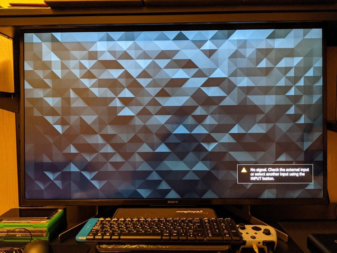

Hello 27.12.2020 bought a TV kd43xh8196. Within a few weeks, yellow spots appeared in the corners. I attach a photo

Сamera did not embellish anything in reality, it looks even worse and the longer the tv is on, it becomes  more visible.

One thing to note here is the pictures you attached (Full brightness, in a dark room) represent kind of a worst case scenario which will outline the phenomenon. are you able to see the bleeding in normal viewing conditions (average lighting, moderate/auto brightness)?

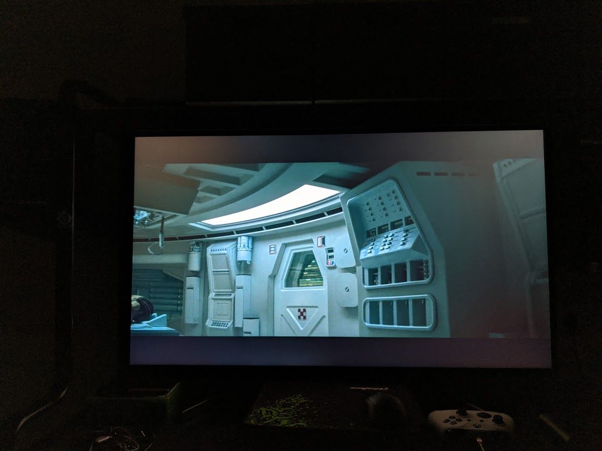

Photos were taken in movie mode, the brightness of the backlight is automatically reduced there. When you unscrew the backlight level as you say to the maximum, it's a nightmare. The TV was also bought as a large monitor. Even in the daytime it is not comfortable to watch movies and work in programs with a dark background like adobe lightroom and davinci resolve and other program with black backgrounds , such as yellowness creeps out on a dark background and and it is impossible to use. Unfortunately, I can no longer take photos since the TV was delivered to the store..
