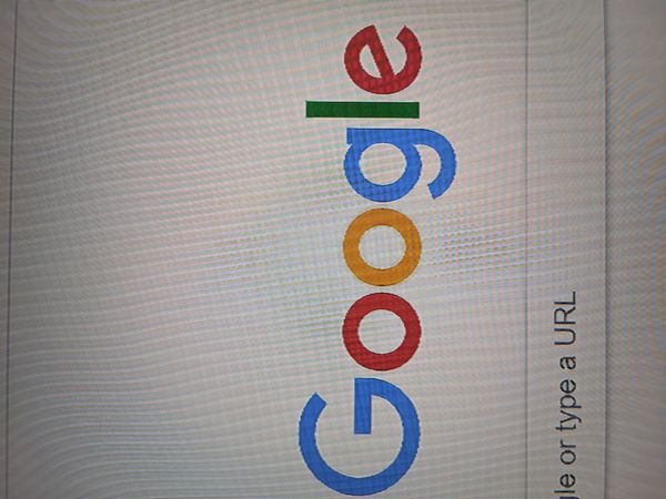

Yes everything is fine in all resolutions at 60hz but as soon as I enable 120hz it looks quite off, I've took some pictures I don't know how well they've come out.
The smooth clear chrome logo is 60hz the blurry jagged edge logo is 120hz.
The Google logo if you zoom in 1 is smooth the jagged 1 is 120hz.
And text is blurry also, There is like white and grey at different levels on grey text, I don't know if you can see in these images but it looks quite awful in person.
For some reason once I uploaded them they have been rotated automatically.

Yes it is clearly blurrier my only doubt was that you were comparing 1080p@120hz  with 2160p@60Hz . I'd suggest you open a ticket to Sony support.
