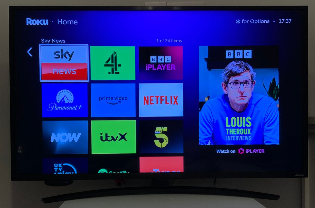

HDMI, but not composite. Your TV has two HDMI inputs, so it will take one of those.
Yes, it’s USB powered, but Roku do supply a suitable power supply and cable. I like to run mine from the power supply; when I ran it from a USB Socket on my LG TV, it worked fine, but as that powered down every time I put the TV in standby, so I had to wait for it to boot up again each time.
And yes it’s WiFi, and yes it has all those apps (Roku call them channels, but they are apps) and yes the Roku runs them, so all the TV has to do, in effect, is be a monitor.
The Roku Express 4K (but not the HD) can be run wired, with extra equipment, but who would want to, normally, if your WiFi is any good?
One thing about the Express is it’s not a stick, it’s more of a stick-on, and they give you the tape. Here’s mine, attached to an LG TV. Bottom left, under the bezel with UK TV above it, if you look closely.
It's very neat, and just looks like part of the TV 😛
